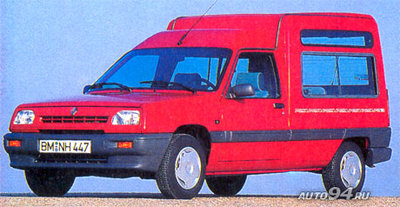

Post by MiKo » Thu Sep 13, 2012 7:46 am
Ja tam ziadny regulacny clen nemam, tak nemam co repasovat..
Renault Rapid/Expres, nastupca stefana..
